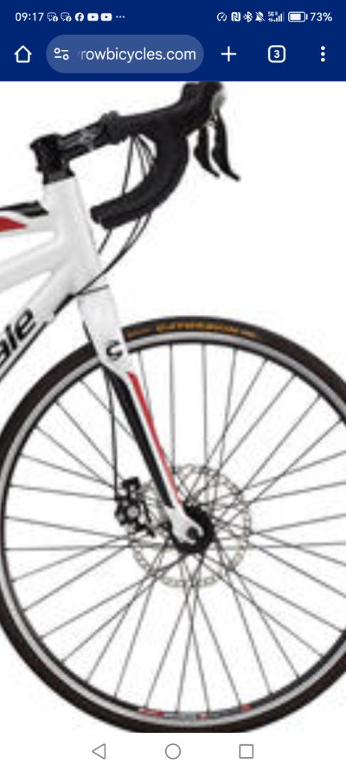

This source lists the brakes as 7 inch front and 8 inch rear - 180/203 - I've re-read to make sure I've got that the right way round
www.machineryrowbicycles.com/product/cannondale-road-tandem-2-196337-1.htm
Michael Brooks2025-10-18 08:07:23
That spec sheet says the steerer is 1.5 inches which is incorrect and looking at the photo graph there is a distinct taper, Which your tandem doesn't have. As far as my research goes it seems that the fork recall was to forks made by kinesis and not the forks made for the USA tandems and that the problem was to the steerer tube. Also the water bottle fixtures seem in a different position.
